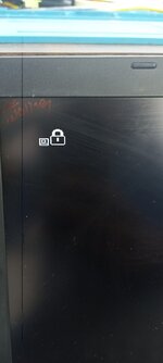

Unlock Bios Password lenovo thinkpad l480 nm-b461
program EC ITE to remove password

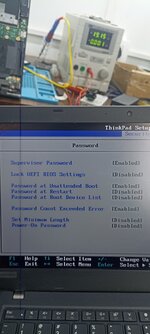

After installing this bios, press f1 to enter setup password press 1234, after 5 seconds then laptop is powering off, password is not unlocked.

you need instruction just when you write the patched bios after that when your laptop is unlocked you need to flash your bios again with your original dump dont worry the password doesnt exist

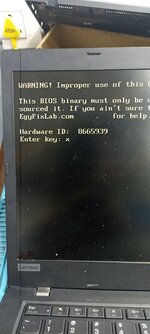

when you flash your bios an id hardware will apear send for me i will send you unlock code

after entre unlock code and every thing is good shutdown laptop and flash the bios with your original bios
